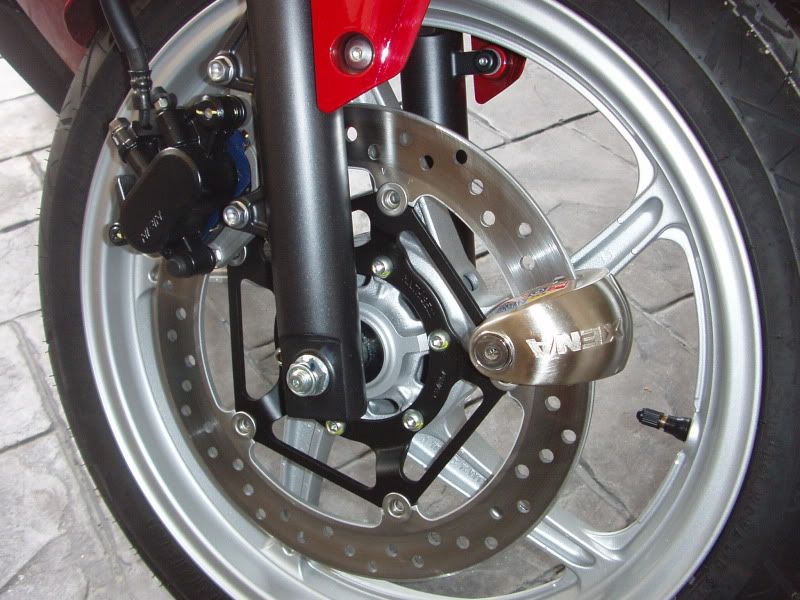

non ABS
this is ABS
ABS have extra 2 cables, thick fluid cable + 1 ABS sensor cable.
there also this slotted disk for the sensor.
non ABS
this is ABS
