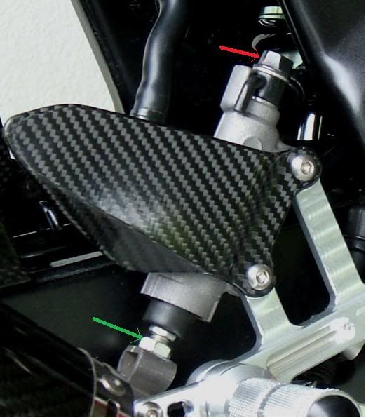

Ok the pic on page 74 of the manual has this noob confused!
So which nut is the adjustment for the rear light switch? Red or Green? Pic borrowed from Tyga.
386 Posts

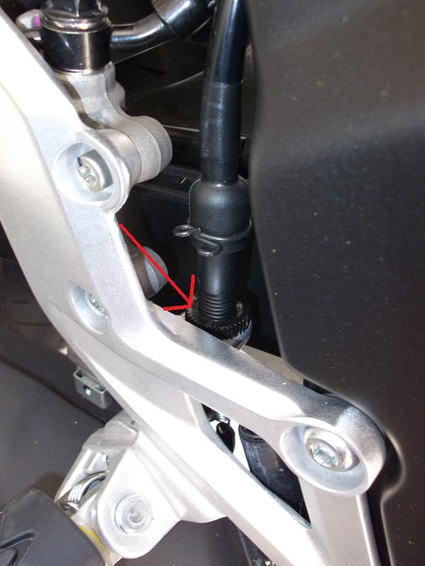

Neither... What you need to adjust is not really a nut, it is a plastic piece that is just in front of the piece shown in this picture near the top nut (the one the red arrow points to). You can turn it with your fingers so no need for tools. I just adjusted mine and i'm very happy with the results.
172 Posts
Thanks guys, I'm not sure why the pic in the manual was so confusing to me.
Adjusted this morning and all is well now.
Here is a pic to help others.....
