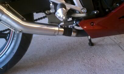

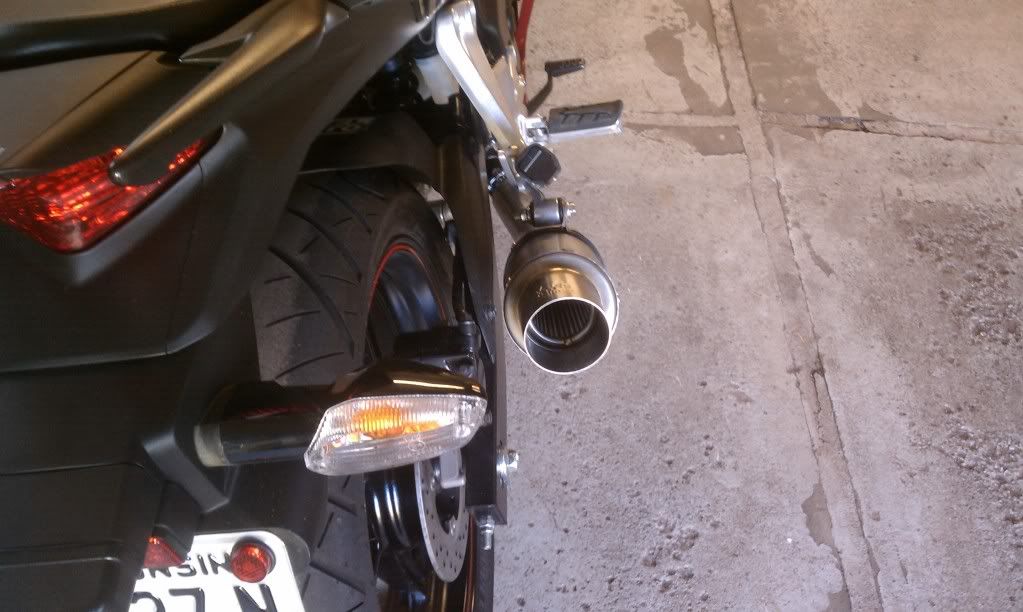

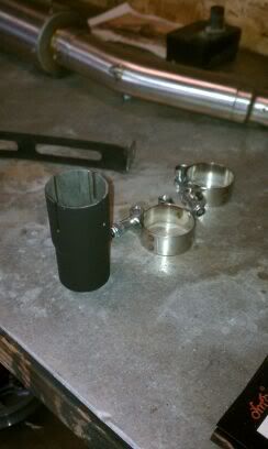

I got my pipe to fit nicely today. All you need are two band clamps and a piece of pipe 3 inches long with 1.5 in ID and 1.5in OD on the other side. I went to the parts store and picked up a reducer, all I did was cut it to length, put 4 notches on the header end, sand blasted and painted it with ceramic paint.
Problem solved, all they need to do is make the mid pipe longer.
