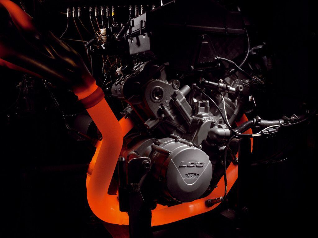

It's not exhaust gases that wear out valves, it's the heat. Temperatures on exhaust valves and seats can get over 750C. This softens metal, causes valve to stick to seat. Some material is lost as valve breaks free. Also softer heated seat compresses causing valve-seat recession.
