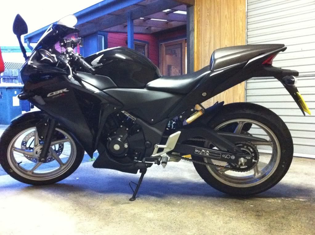

Well fitted my tinted screen today.
Part Number 08R80-KYJ-700
So to install it was a royal pain. 4 hours worth.
You need to remove the 2 side fairings
Need to remove the whole front light and dash
Need to remove the gauges out and the light assy out
All that to access the windscreen
So here is some random pics
Fairings off
At this point what you do is pull out one of the bolts holding the front end on so it piviots down then you can pull the dash out and remove the wire clips from the front end to remove the front end.
Nude front end :D
DECAPITATED
Got bored and threw a T5 red LED into the N light on the dash
Fitted
Bike now looks like this
You can see my rego tube with rego label in there on the mount where the passenger footpeg was
Still waiting on my R&G racing tail tidy to turn up, then I can mount it and LED rear indicators.

Yes its pre tinted, built into the colour of the plastic.
Yeh thats some 3m Di-Noc, Just a small bit I had laying around to protect that area.

Yeh I was surprised how annoying it was but once you work the fairings out I could do it in 2 hours.
3M wrap came from eBay from an aussie seller but there is plenty of US sellers on there.

Both the seat cowl and the tinted screen are HONDA items.
Alas the US dont seem to have a carbon one (its fake carbon print) and have a matt black one. For about half the price of the fake carbon one I got here in australia of honda

Remove the 2 side fairings
to remove the nose, pull out the top bolt, then loosen the lower one and pivot the head onto the front fearing on the wheel so you can remove the gauge unit (4 visible bolts then pull it out with force)
undo all the electronics to get the nose off
then pull the metal frame from the nose, then the head light
reverse it all to get it back in.
