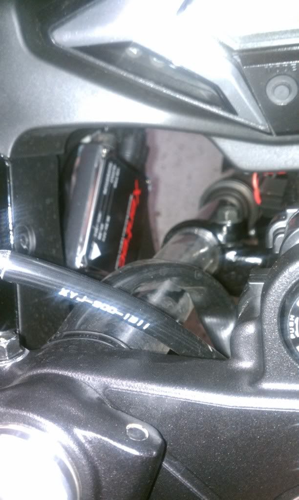

BBR- can u pls post a detailed installation guide ? how did u manage to get the headlight opened up. did u had to remove the fairings?
I did not take anything off the bike, Just need to reach up, pull the rubber cover off the back of the bulb, release the spring that holds the bulb in place and swap it out with the HID bulb. Blug your wires in "all plug and play" mound the ballast where ever you want and your set.
