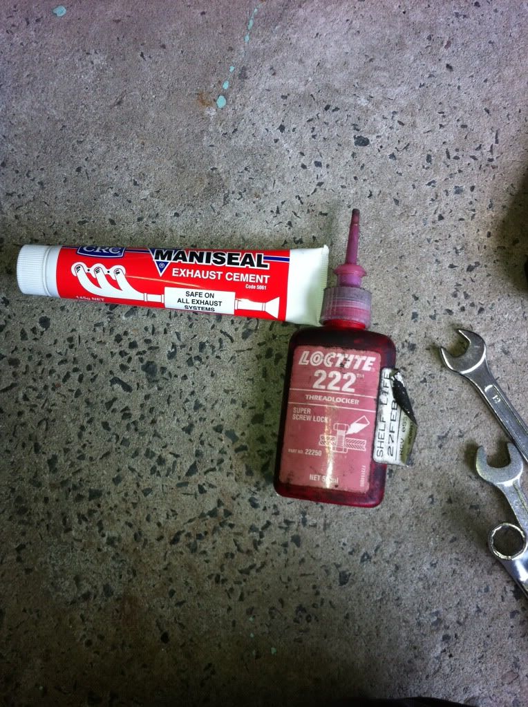

Ultra high temp Anti seize lubricant fitted, Rated around 2000deg C Its used on aircraft parts, I work on aircraft ;)
Remember the loctite and some exhaust cement for the header pipe
Tighten it all up and BAM
