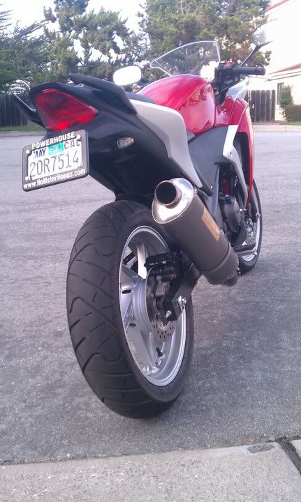

Where did you relocate the rear brake reservoir? I've been trying to map that out in my head all week and haven't come up with a solid solution yet!
well i eliminated the resevior all together and just ran a tube up under the right side of the plastic. The tube itself holds enough fluid to supply the master cylinder. i added a breathable cap to the top of the tube and routed it to were i could check it regularly.

looks good,from the wear mark on the rear tire you like the corners.

The problem with the rear rake resevoir is that brake fluid will take on or absorb water. Brake fluid should always be kept dry (sealed). So I am not sold on this vented cap, it is a cool idea, brakes dont need a lot of volume unless they are leaking and that is a whole different problem. But the moisture has to be kept out or the fluid could loose its hydraulic properties.
