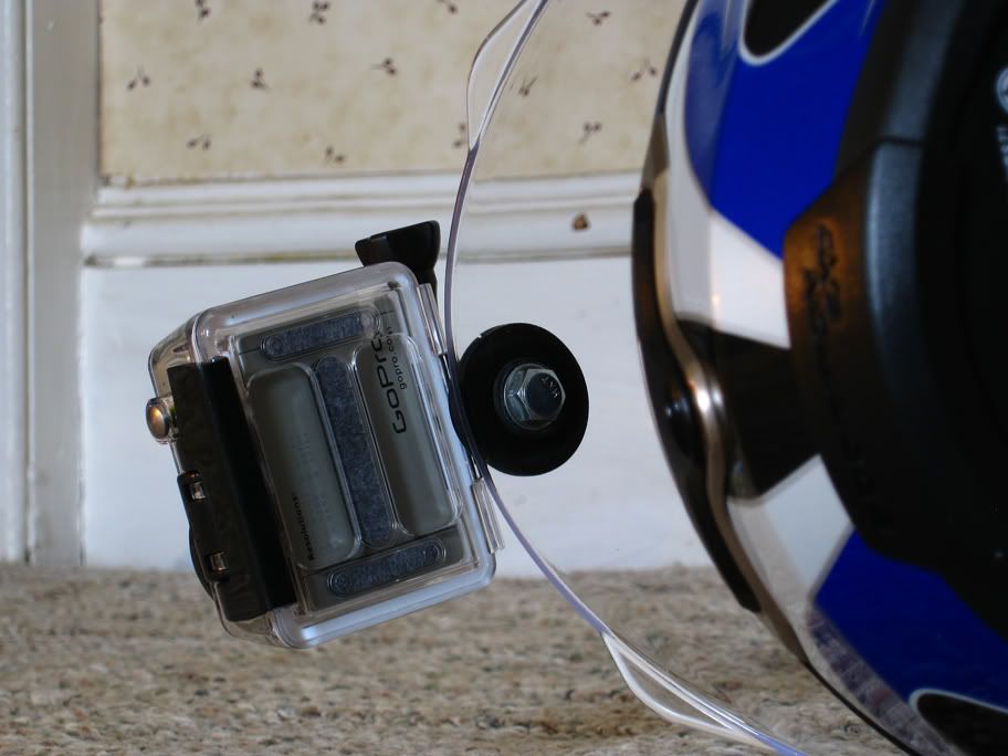

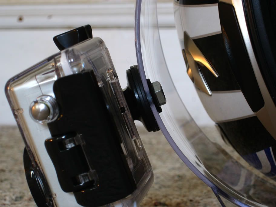

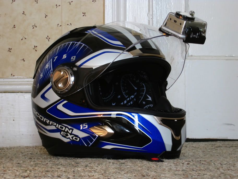

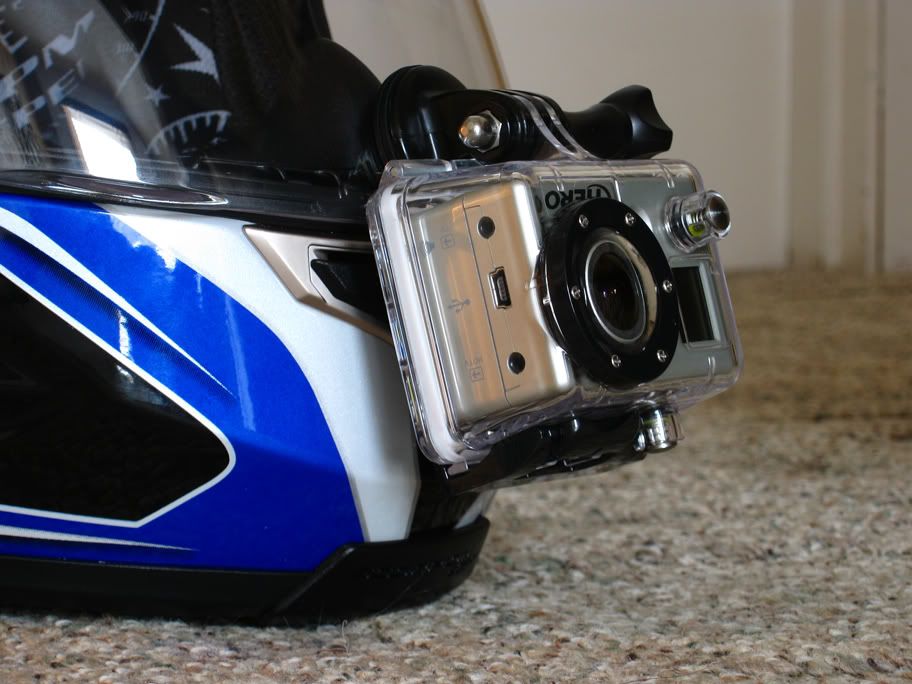

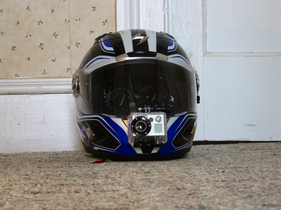

This how I chose to mount my GoPro. Drilled a hole dead center of the face shield about 1 1/4" from the bottom, attached camera using the GoPro tripod adapter, a 1/4"-20 bolt,1 metal washer and 2 rubber washers (large and small). I did not trust the adhesive mounts and also this puts the view point right where i want it as it is only about 3 inches below my eyes while still not obstructing my vision. Captures bike (grips, speedo, shield) in lower 1/3rd of shot and road in upper 2/3rds.
350 Posts
Wow. That is semi-brilliant!
And, the shield is easily replaceable in the event you get tired of this solution, or simple enough to keep a spare shield when you leave the cam home... No adhesive on your helmet...
Kudos --
