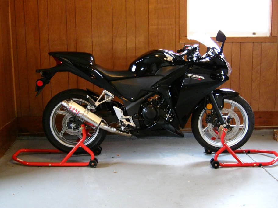

I know a lot of people have made threads on how they are going to store the bike for winter... so here is what I did with mine.
Place bike on paddock stands (swingarm and fork) and put in neutral
Added Sta-bil to fuel and Ran bike to full temp
Topped off fuel to brim
changed oil and filter
removed left crankcase hole cover and manually turned over engine a few times to circulate oil into filter cavity
topped off oil to max mark (level drops about 1 quart when you turn over motor)
cleaned, lubed, and adjusted chain tension
removed battery and brought into house (place on tender once a week to keep it topped off)
washed EVERYTHING by hand with sponge, toothbrush, and spray bottle with plain water (in garage so cant use hose)
waxed all painted surfaces (cowls, fairings, ect)
Used spray silicone on rag and wiped down all metal parts (motor, muffler, frame, forks, swingarm, ect)
inflate tires to proper pressure and spin to check alignment
wipe brake discs with rag and 91% alcohol
cover bike
Now this may seem excessive to some... but if your thorough then that's less problems and work you gotta deal with in the spring:D

Nice..Ill be parking mine soon. its getting cold here everyday. thanks for your info. by the way where did you buy the rear and front stand ? i want to get one but dont know what kind. Do you need a special adapter for it ?
thanks again.

got mine from flyncycle.com... but can't say i would recommend them. They make me nervous and are designed poorly. they come in three pieces (each) and they flex and bend a lot. I'll be getting solid 1 piece ones in the spring.

I'm new to all of this. Is it necessary to get the tires off of the ground when storing for the winter?
Ideally, yes. If not, put an extra 5lbs of air in the tire(s) that are on the ground, and put some rubber or cardboard under the contact area. If you can, give the tires a spin occasionally to keep them from flat spotting.
