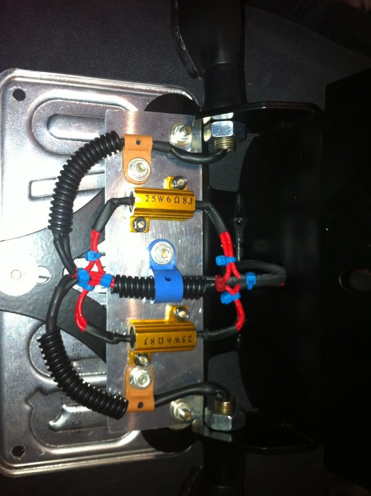

Mounted the plate and did all the wiring for the resistors and LED indicators on a custom bracket. Resistors are used in parallel with the indicators to maintain the normal flash rate.
