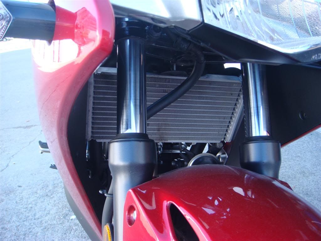

I added this guard for the radiator - did the same thing on my Kawasaki Versys. The manufacturers should include protection for the radiators on these 2 bikes. This is just a piece of black powder-coated 6 inch gutter guard; the type that is L-shaped in cross section because it snaps into the outer edge of the gutter. I just cut it to the length of the radiator's width and then zip tie it on. I screw a small rubber foot in the middle of the bottom edge that rests against the radiator to maintain the gap between the guard and the radiator on the bottom edge. It is kind of hard to see in the photo - the camera kept trying to focus on something else.
