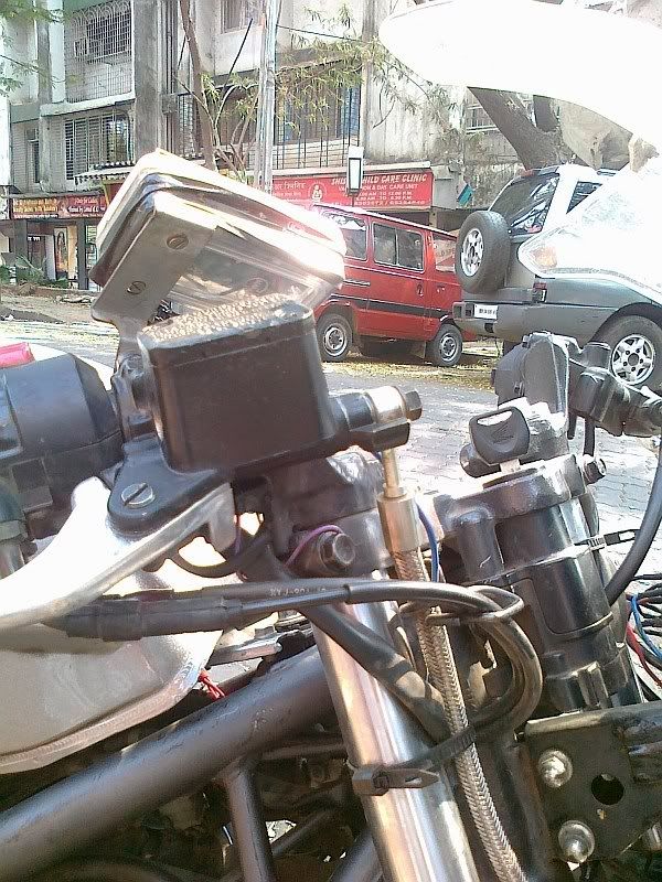

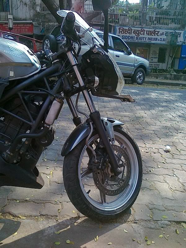

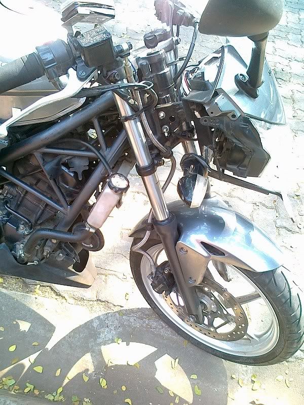

Teflon lines, SS braided.
The CBR brakes are, IMO, pretty good anyways, but you get a rather better feel while braking hard, giving better control. You're not likely to need this during your regular commute, but it's something extra during hard braking as in an emergency situation, or while having fun in the corners!

Discussion Starter · #3 ·
This was made at the local industrial unit by an outfit that specializes in manufacturing hydraulic tubing, various sizes, lengths, materials. I provided the stock line, they did the rest (mounting clips not included, you'll have to cut and use those on the original line). You can contact these guys:
