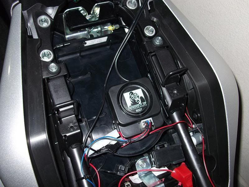

Installed the Gorilla 8007 alarm this morning, very easy, only had to remove the seats, and fairing to run the LED light wire up front. I removed the rubber strap that is under the seat. I carry everything I need in the tank bag now.
It is loud enough to get attention (my only real expectation) and is easy to adjust the sensor to match the lean angle of the CBR on its kickstand.
I'll keep posting how it does long term. For $55, I just want it for times when I can not keep an eye on the bike; and for the tilt sensor that will sound the alarm as soon as the bike is lifted up off its kickstand.
It does also have a shock sensor and is voltage sensing if there is an attempt to hotwire the bike. It does not offer ignition kill.
For what it costs, it seems to be ready to keep strangers off your bike. As I said before, I would still combine it with a disc lock.
My CBR is not a commuter or daily driver, so I would keep that in mind, if yours is, then maybe a more expensive elaborate alarm may be in order.
Here are a few pics. It fits under the seat no problem. I used the supplied velcro to hold it down but it does come with a metal bracket. I put the tilt sensor on the wall where the rear seat attaches. It has to be vertical and pointed towards the left. It is a mercury tilt switch that closes with anything more than a 30 degree angle when the bike is lifted upright off the kickstand.
Still need to ziptie the wires, The black wires going out the rear of the bike is my battery tender lead, nothing to do with the alarm.
